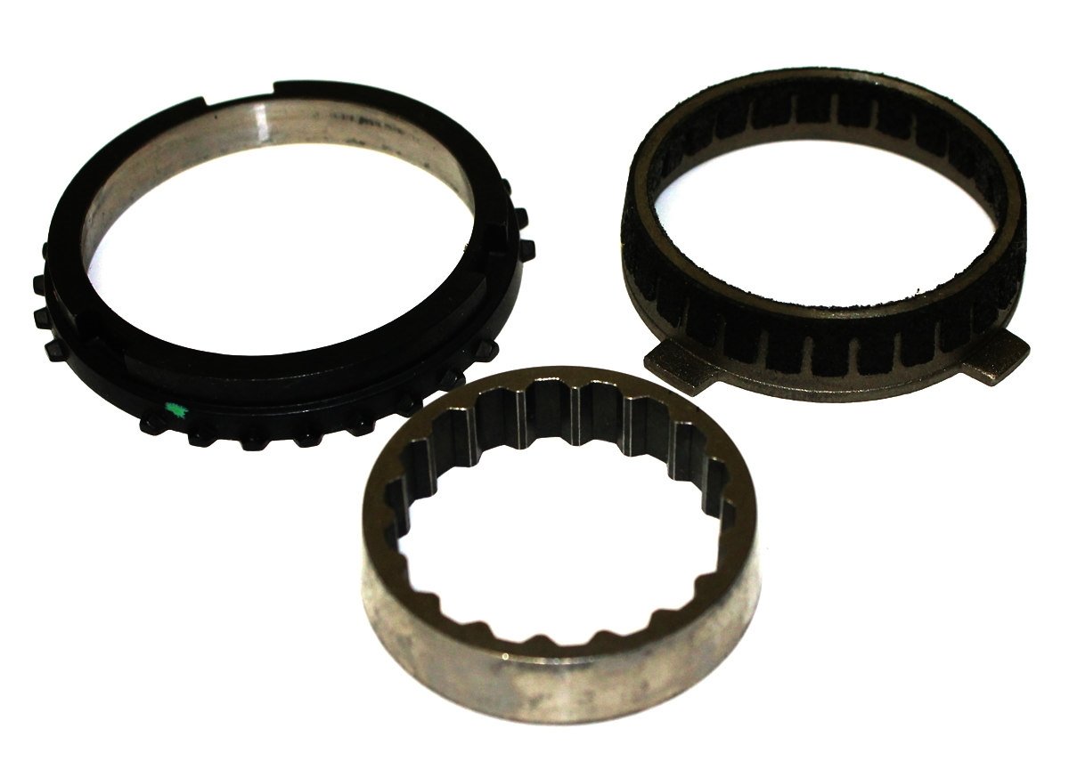

There is a BIG difference between the Borg Warner NWC T-5 and the WC T-5, and they use different oils. All the synchronizer rings in the Non-World Class (NWC) are made of solid bronze, and are of different size than those found in the World-Class (WC) T-5. It is because there are no bearings under each gear and the bronze synchro gears that the NWC T-5 use the heavy 70W gear oil.
In 1985, Ford introduced the World Class T-5. No longer were 1st, 2nd, and 3rd gears spinning on a solid output shaft as needle bearings were installed under each gear to reduce drag. The lower counter gears also saw tapered bearings to replace the bronze thrust washer.
All main shaft synchro's were fiber lined steel rings to improve rings friction surface while 5th remains bronze. All WC T5’s use ATF oil or Synthetic ATF (no other oil should be used. Redline MTL should not be used, but Redline ATF is fine. Amsoil ATF could also be used). By improving the surface friction the synchro slows the gear faster making for smoother shifts.
Re: mitä laatikkoöljyä sn 95
Tässä syyt öljyn oikeaan valintaan.
Synkro renkaat.
ja

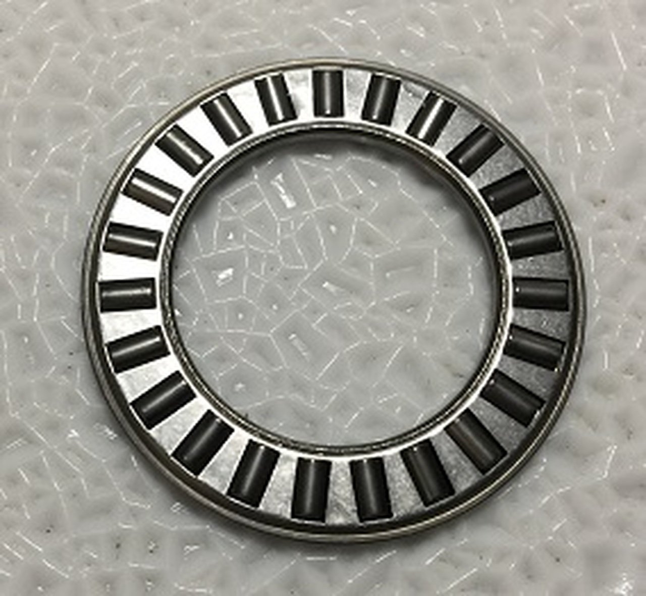

Vaihde rattaan akselilaakerit.
Näille pitää olla oikean lainen voitelu.
Ja onhan tuolla WC T5 askissa muitakin oikein voideltavia kohteita verrattuna vanhanmalisiin Ford Toploader ja BW T10 askeihin jne.
Voi olla, ettei nyt rusahda, mutta joskus myöhemmin rusahtaa kunnolla.
