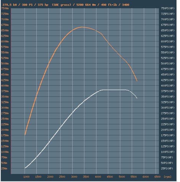

The Horspower / Torque Curve below was generated by the ProfessCars™ software, based on the factory data:
1969 Ford Mustang Boss 429 (man. 4) engine Horsepower / Torque Curve
Engine horsepower and torque curve for Ford Mustang Boss 429 (man. 4) in 1969, the model with 2-door fastback coupe body and V-8 7033 cm3 / 429.2 cui, 279.5 kW / 380 PS / 375 hp (SAE gross) offered since April 1969 for North America U.S.. Detailed engine characteristics.

What power?
Horsepower net:
Torque net:
Horsepower gross: 279.5 kW / 380 PS / 375 hp (SAE gross)
Torque gross: 664 Nm / 490 ft-lb
Car power to weight ratio net: 131 watt/kg / 59 watt/lb (estimated by a-c)
Car weight to power ratio net: 7.6 kg/kW / 5.6 kg/PS / 12.5 lbs/hp (estimated by a-c)
