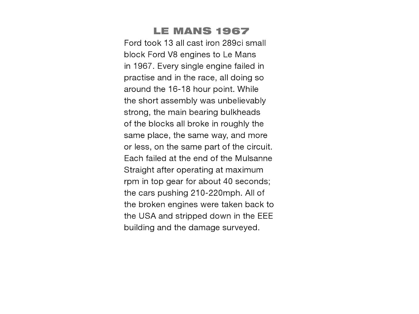

Re: SBF Moottorilohko... vakio vai aftermarket

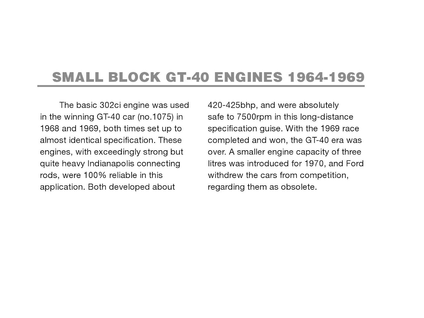

LE MANS 1967
Ford GT 40 / 289 / 302 engine

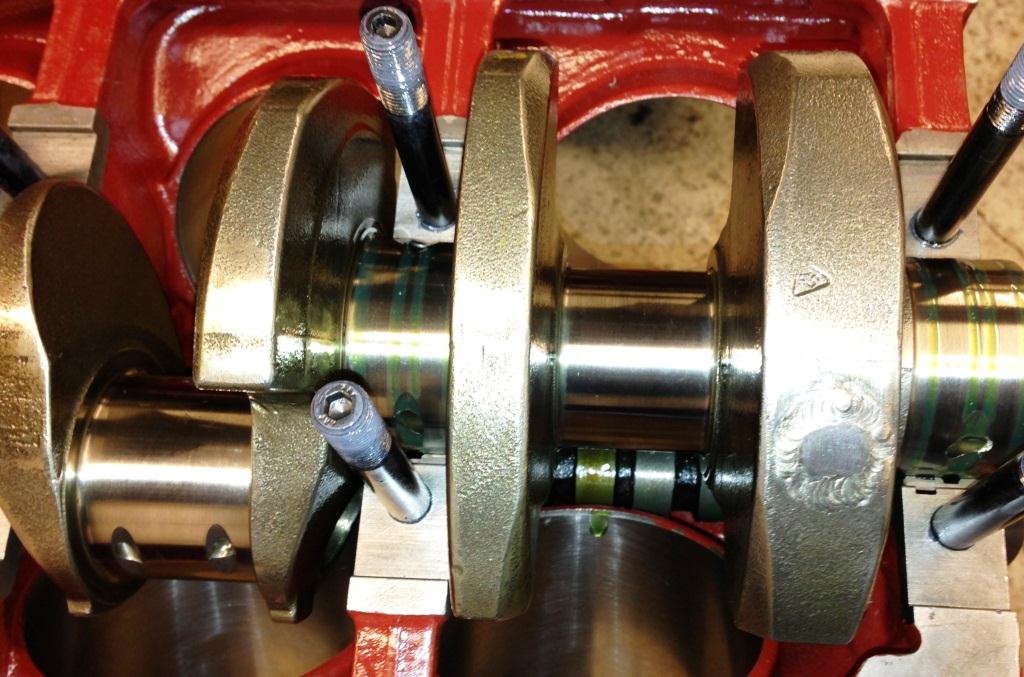

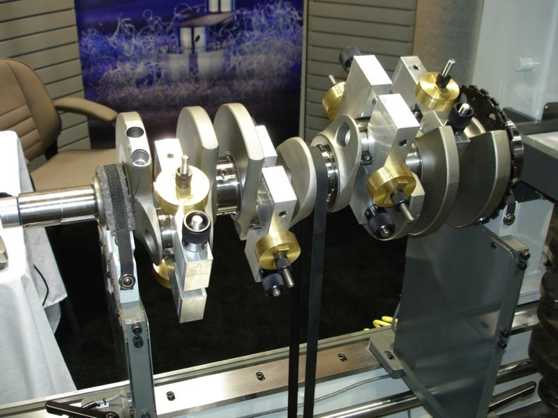

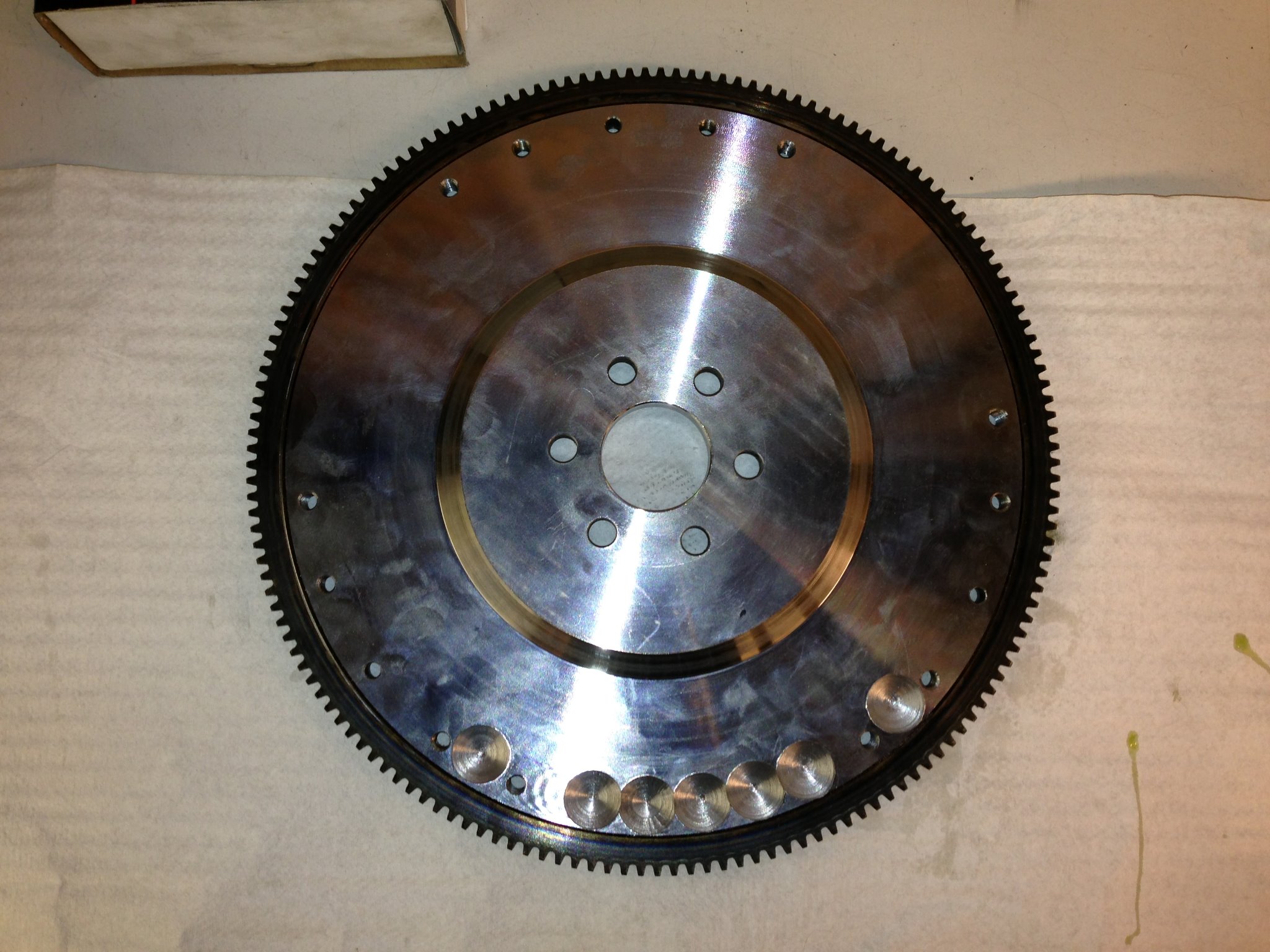

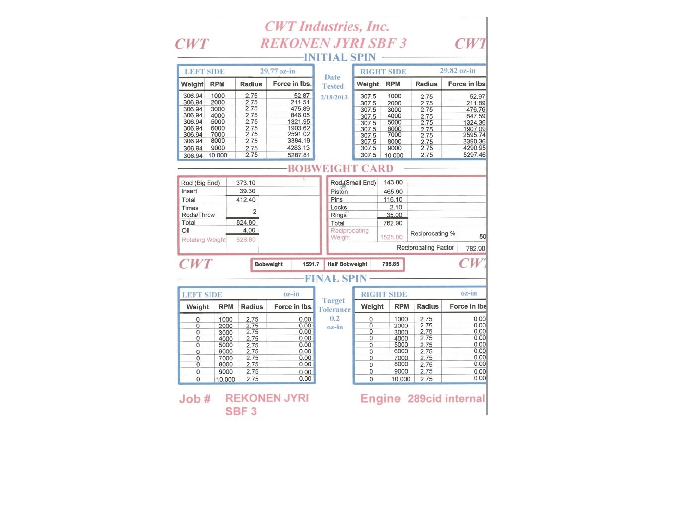

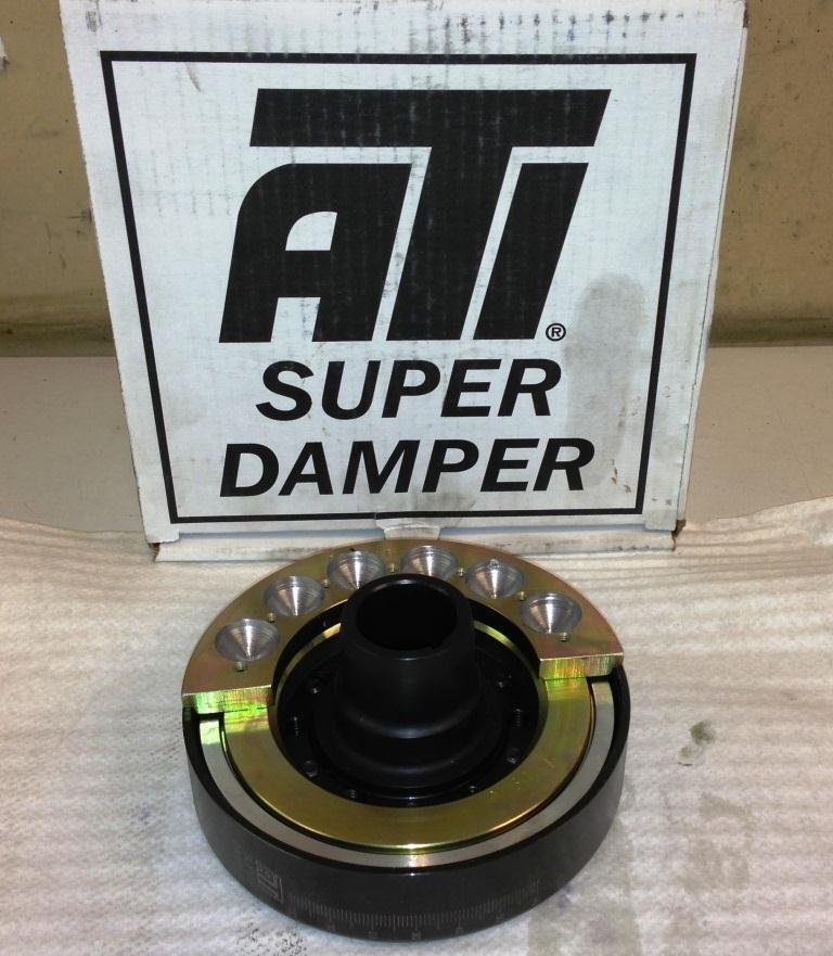

External Balance: The crank is spun with the external balance and flywheel. If it is determined that the assembly is too heavy where the weight is on the damper and flywheel, do not make the correction on the end counterweights of the crank. The out of balance condition is in the damper and flywheel, which is where it should be corrected. It is very simple to alter the bolt on weight of the damper and drill the balance weight on the flywheel. If these components need to be replaced simply bolt on the proper weight to the damper and match balance the flywheel which has to be balanced anyway. If you correct in the end counterweights, you will create a wave in the crank which will wiggle the nose of the crank which well eventually start a fatigue crack which will snap the crank.
Tuossa minulla nyt autossa olevan 289:n kassa toimittiin juuri näin. Jätettiin koskematta kampiakseliin (itseasiassa siihen tehdyt reiät tulpattiin -> lisättiin massaa) ja lopuksi Damperiin ja vauhtipyörään tehtiin tarvittavat kevennykset eli kevennettiin ulkoista massaa, -> että damberi ja vauhtipyörä käyvät vain tähän yhdistelmään ellei niitä taasen muuteta sopiviksi toiseen.

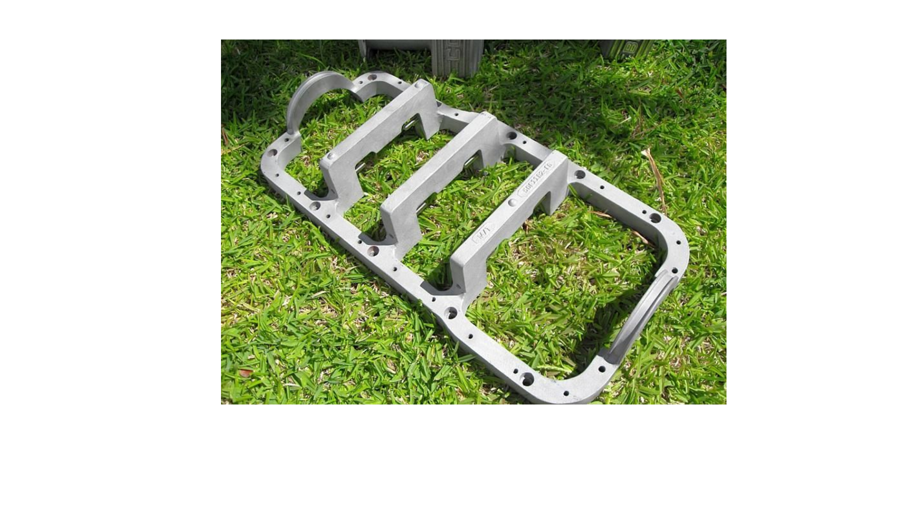

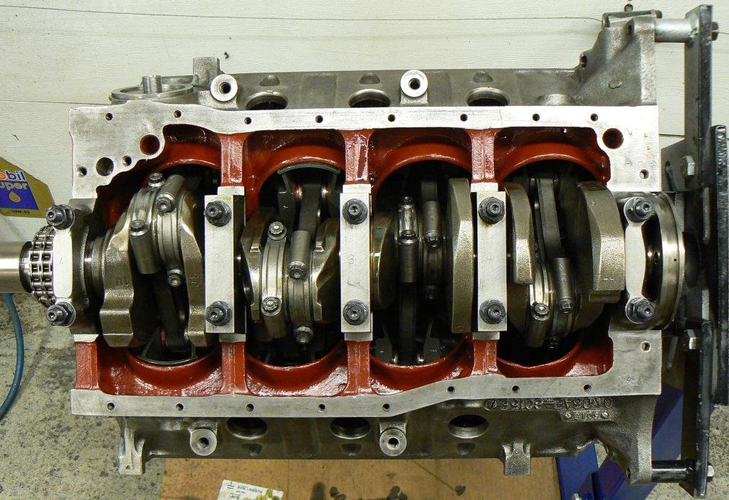

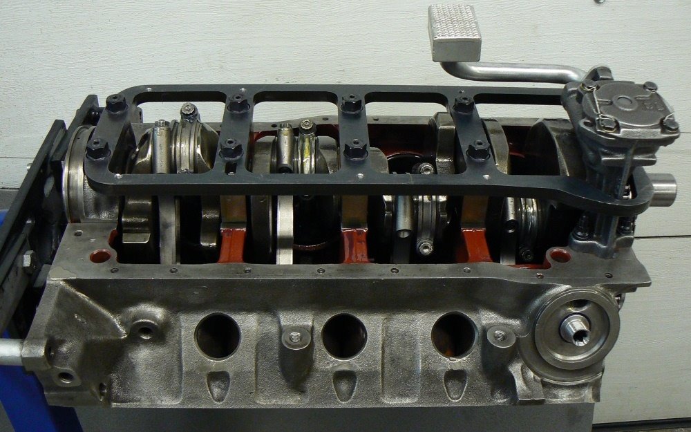

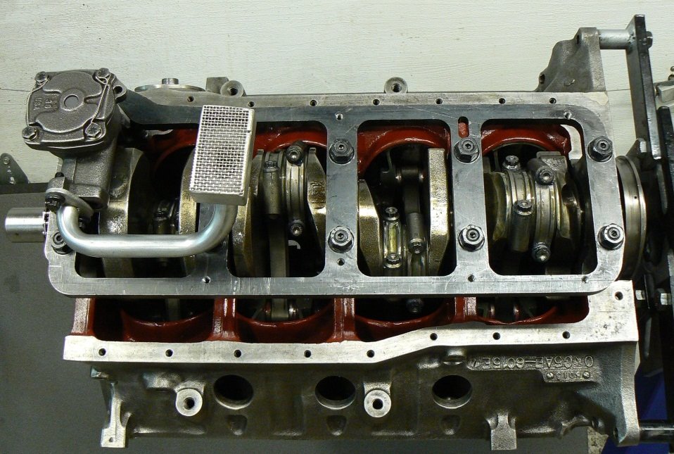

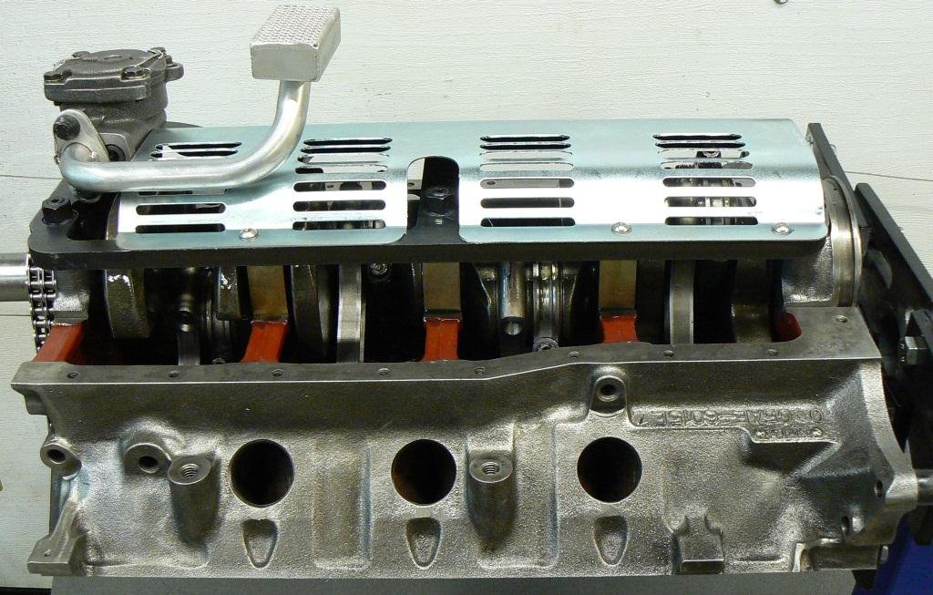

Onhan noita tukisiltoja tehty toisenlaisiakin.

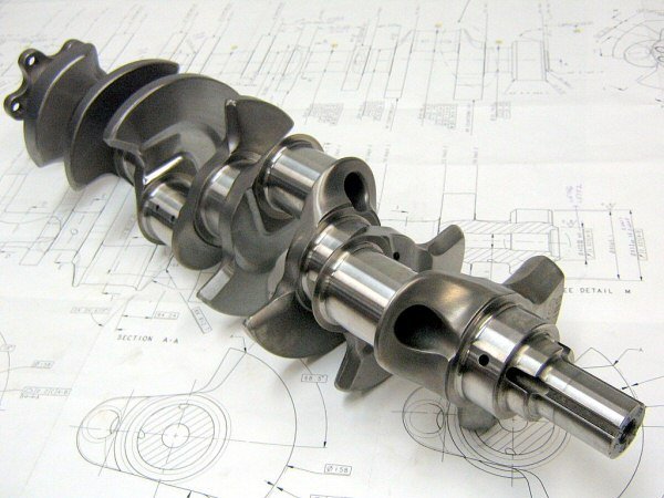

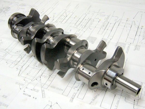

In the world of two-plane V8 cranks, the traditional calculation for the balance-bobweight value is 100% of the rotating weight (big end, inserts and oil) plus 50% of the reciprocating weight (small end, wristpin, retainers, piston, rings and oil). However, there are differing approaches to the question of overbalance or underbalance. Some experts stick with the 100% + 50% distribution, while others opt for a 46-47% underbalance (100% + 47%). Others prefer a 52-53% overbalance, while others add an arbitrary 100 grams to the 50% reciprocating calculation. There was a general reluctance among the crankshaft experts with whom I spoke to discuss the expected or observed effects of these strategies.
Palaan hetkeksi vielä kampiakseliin koska se aiheutaa lohkoon erilaiset värähtelyt, ja sitäkautta lohko saattaa kestää tai siten ei.
http://www.epi-eng.com/piston_engine_te ... issues.htm
Weighing in on Balancing Work
http://www.enginebuildermag.com/2014/03 ... cing-work/
Tipping the Scales
http://www.enginebuildermag.com/2015/12 ... he-scales/

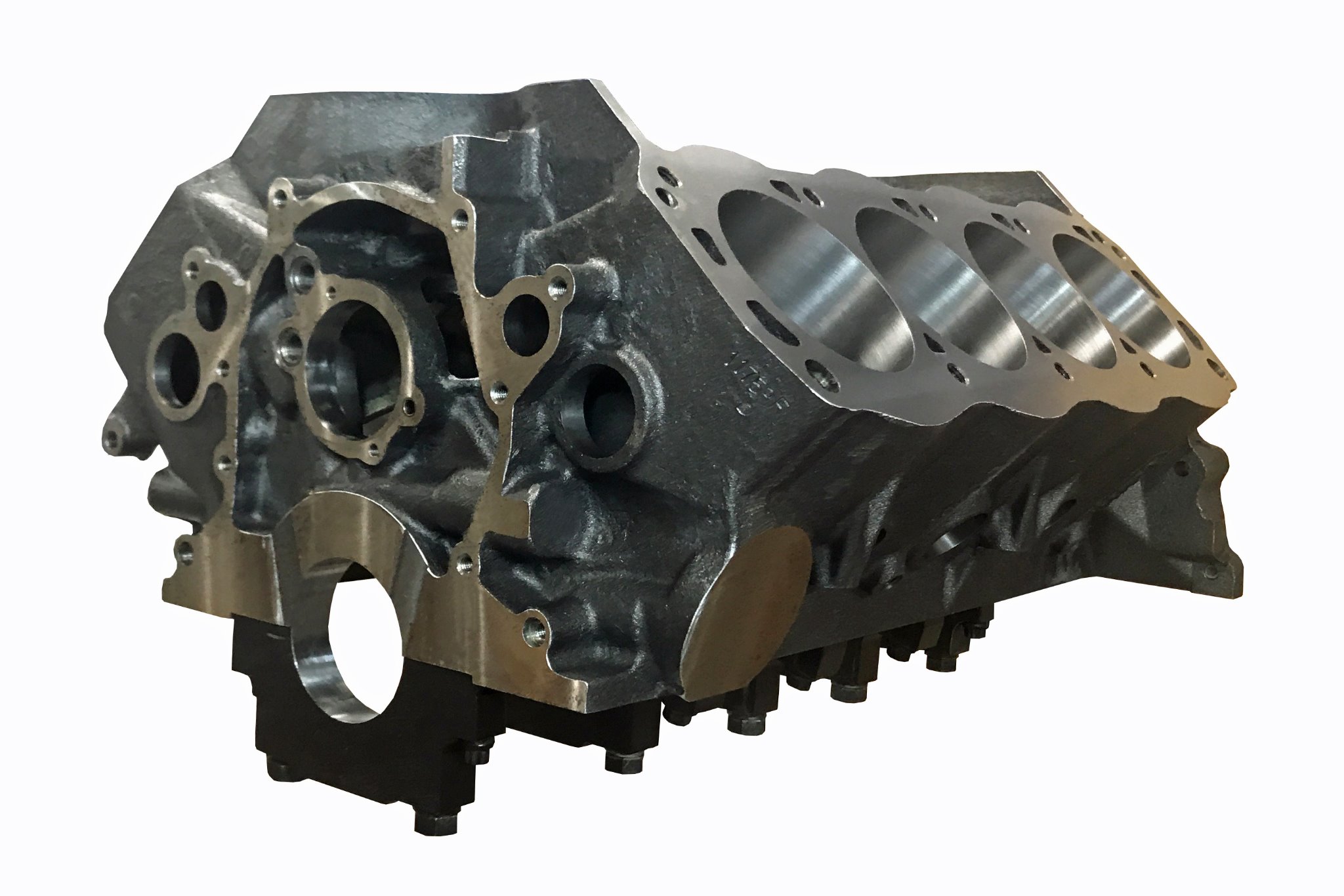

Tuossa voisi olla vastaus vahvaksi lohkoksi, ei kovin paljoa tavitse vahvistella.
“I would say [the Iron Eagle Pro] is a good idea on any power-adder engine seeing 2,000 horsepower or more and/or if you are running an alcohol engine with over 30 psi of boost,”
In pursuit of an ultimately capable iron block, Dart has selected a high-strength iron alloy, which comes in at 220 Brinell hardness, which is quite stout for iron. It also comes with the option of screw-in freeze plugs, and the block can be machined without the distributor bore, for front-drive distributors and coil-on-plug applications. By leaving that area unmachined, additional strength can be added to the combination.
Deck Heights and Main Sizes
With so many competition-specific features, you might be wondering about what combinations are going to be offered in relation to potential engine displacements. The short answer is, “all of them.” All four small-block Ford deck heights will be offered, with the 8.200-inch and 8.700-inch models coming with 302 main bore sizing, while the 9.500-inch deck height comes standard with the 351 Cleveland main bore diameter. The 9.200-inch deck height option is available with either 302 or 351C mains.
All five of those potential combinations are available in either 4.000-inch or 4.125-inch bore sizes, with a maximum finished bore size of 4.185-inches across the board, for ten part numbers across the Dart Iron Eagle Pro lineup
Dart’s New Iron Eagle Pro SBF Blocks Make Custom Features Standard
http://www.enginelabs.com/news/darts-ne ... -standard/
darts-new-iron-eagle-pro-makes-custom-features-standard-2018-04-16_21-32-53_982988.jpg
