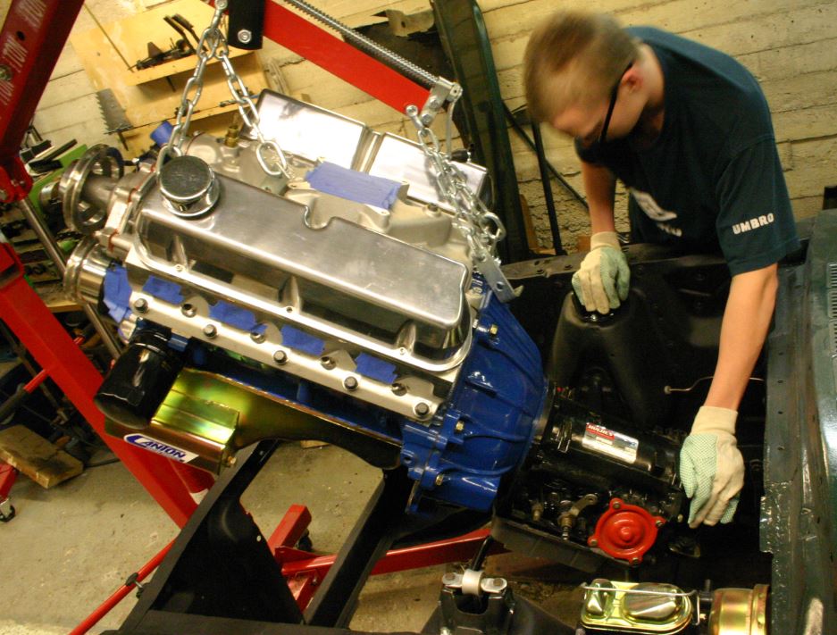

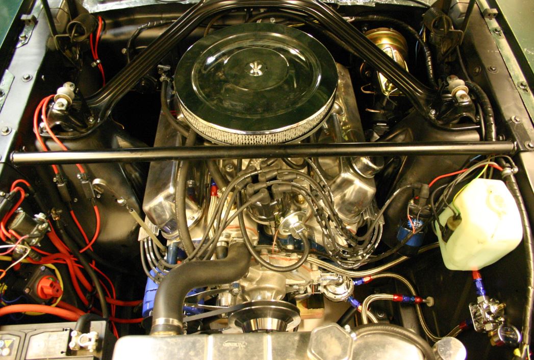

348 maalattu oma vanha kone:
Tykkään itse tuosta paljaasta alumiinistakin, eli maalasin vain lohkon ja turbiinokopan. Itse lohkoa ei paljoa näy kun on koneeseen asennettu (kuva kun pojan kanssa viime keväänä konetta istutettiin).
Jos maalaat kannet ja imusarjan, niin näkyy tietysti paljonkin sinistä.

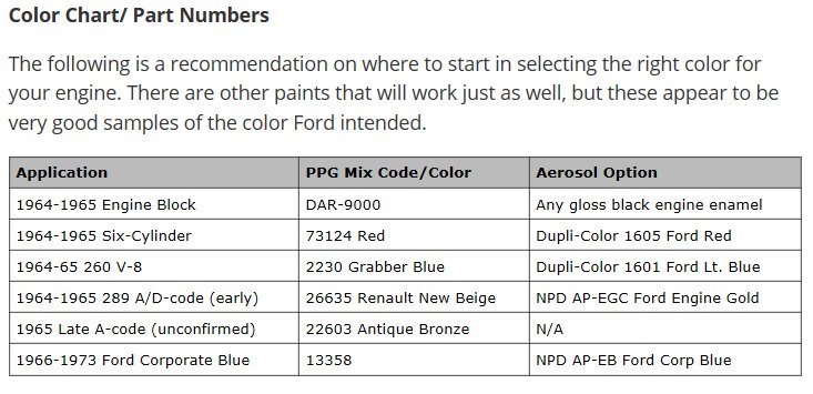

http://www.mustangandfords.com/how-to/p ... ine-paint/
’65 Mustang Engine Color Quick Reference
Engine/Part Color Brand
200ci valve cover Red Duplicolor 1605
200ci air cleaner Red Duplicolor 1605
200ci block, head, oil pan gloss black Duplicolor 1635 (semigloss black)
Duplicolor 1613 (gloss black)
289ci valve covers Gold Duplicolor 1604
289ci air cleaner Gold Duplicolor 1604
289ci block, heads, intake manifold,oil pan gloss black Duplicolor 1635 (semigloss black)
289 High Performance valve covers Chrome N/A
289 High Performance air cleaner ChromeOpen Element N/A
289 High Performance block, heads,
intake manifold, oil pan gloss black Duplicolor 1635 (semigloss black)

Mustang&Fords:
1966
For many years prior to 1966, Ford engines were color-keyed to specific applications and carlines. For 1966, this practice changed, when all Ford engines were painted Ford Corporate Blue. Instead of color-keyed valve covers and air cleaners, the entire engine would be Ford Blue, like the Ford Blue Oval and the Ford Blue offset dealer signs popping up in 1966. Ford's message for 1966 and beyond was simple-if it is blue, it is power by Ford.
As in 1964-'65, Ford continued to paint the valve covers separate from the engines. Engine long-blocks, which included block, intake manifold, heads, and oil pan, were all painted Ford Blue, a darker blue that covered all hardware except the valve-cover bolts. Valve covers were installed toward the end of engine assembly using natural metal bolts with integral lock washers. We've learned through observation and conversation with restorers that Duplicolor's Dark Ford Blue (1606) is an accepted color for '66 and later Ford engine restorations. An alternative, when Duplicolor isn't available, is Krylon's Dark Ford Blue, which is also the correct shade of dark blue. Plastikote is another paint brand, Royal Blue (1134) an acceptable color for '66 and later.
