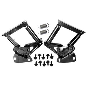

Voisiko tuosta olla apua?
Mustang Hood Hinge Kit (1965-1966) Installation Instructions.
http://www.cjponyparts.com/install-must ... 1965-1966/
