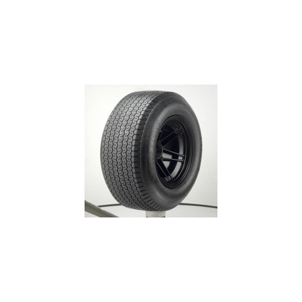

550 tai 600 M15 Dunlop Historic Race Tyre
Popular tyre in pre '66 Touring cars for Mustang and Falcon. Also pre '66 GT car and sports racing cars, such as Lola T70 Spyder and Mclaren M1. FIA Appendix K required tyre in historic racing.
Mutta kuitenkin tulevana kesänä pyöriialla enimmäkseen seuraavat mustat rinkulat:
