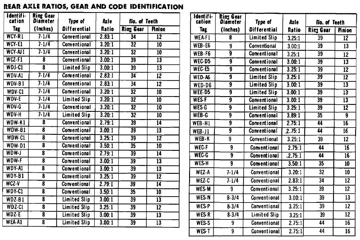

Re: 8" perän välitys
Tässä välitykset liitteenä 1968 workshop manuaalista. Tässä 4 konstia saada välitys selville:
There are four ways to find a ratio.
1 A dealer can normally tell from the vin number.
2 There are normally tags or labels on the axle that have part number, gear ratio, and fluid requirement info.
3 You can count how many times you have to turn the driveshaft to get one complete turn of the tires.
4 You can divide the number of teeth on the ring gear and divide by number of teeth on the pinion.
